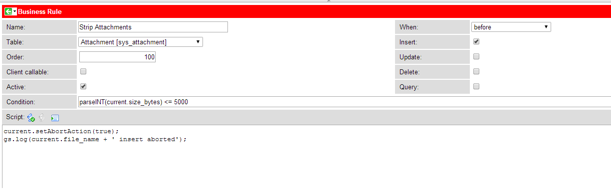

I am trying to strip all attachments that get picked up by ServiceNow under 5000 bytes so we can avoid unecessary attachments of users signatures to records.
I have looked at some examples posted already and setup something similar.   My issue is, the business rule on the sys_attachment table seems to run as I can see the script log showing the name of the file being aborted, but the email log itself, is not capturing the target (remains as empty) and not communicating back to the record.   If i turn off this busienss rule, it works fine again.
Any ideas what the issue may be?
(see attached business rule detail)

I found this, or the starters for this on here somewhere, but we have this
in sys_attachment, create a Before Insert Business rule
The condition is
parseInt(current.size_bytes) <= 1800 && current.content_type.toLowerCase().indexOf('image') != -1 && current.table_name.toLowerCase().indexOf('zz_yy') == -1 && current.table_name.toLowerCase() != 'sys_email'
and the script of
current.setAbortAction(true);
//gs.log(current.file_name + ' : insert aborted');
Cheers

I found that I had to remove the last part of the condition in my instance to make this work.   .
If I leave that one there, it still attaches the images from the signature. If I remove it, it acts as expected.
I am wondering if I am creating an type of issue by removing it.
