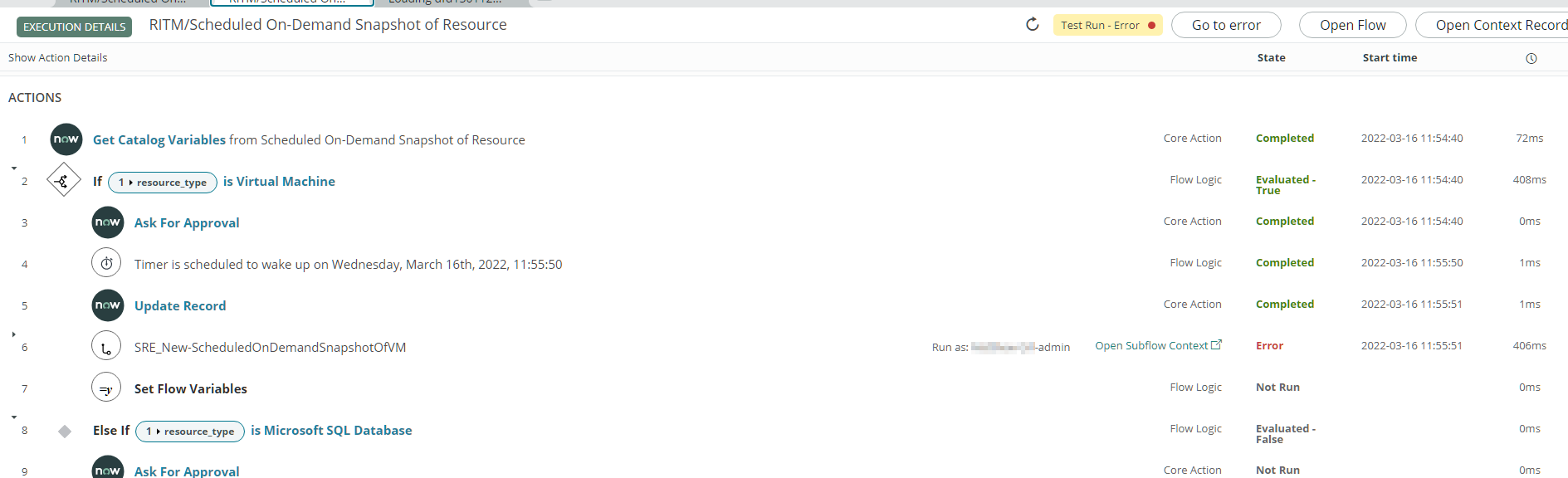

I am calling Sub-Flows within a Flow. The Sub-Flows return [status] which is a True/False variable. The Sub-Flow tests correctly, but when it is called from the Flow the Sub-Flow completes, returns the appropriate output when looking at the subflow execution details, but the Flow execution details show an error for the Sub-Flow task.
It is as if the Sub-Flow output variable is not being passed back to the Flow. I have ensured that the variable types are the same, and the Sub-Flow is set to 'Wait for Completion). Any advice or guidance is appreciated. Thank you!

Alright... Support figured out what the issue was.
Even though the error was being shown on the Sub-Flow call, the issue was actually failing on the Update Record Action. Specifically, updating the 'Actual Start' field. I was updating to " return ( new Date() ); "; however, that field requires a String, for some reason, and was not giving a good Error Code. The workaround is to update to " return ( new Date().toString() ); ". Not ideal, but it works...

Can you share your Flow/subflow configuration, and execution details?
Matthew Gill
@Appli the 'Wait for Completion' was already set to true.
Hi, if you click the 'Go to error' button does it provide you with any useful logs to help diagnose further?
