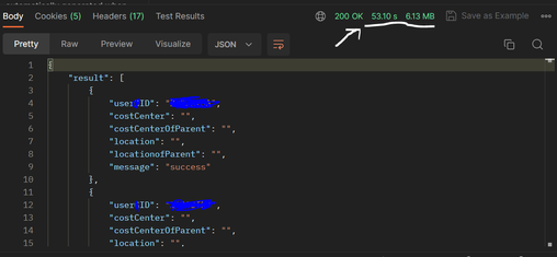

I have created a Scripted REST API endpoint and would like to send a custom table data (specified fields only) of size 50k records - ~7MB (1.5 minutes) when I checked via Postman. Below's the script I'm using in the Scripted REST Resource - GET

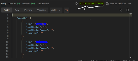

Found this link and configured the streaming part and I think the first method I used fits in with the Object Serialization method, but I could be totally wrong here. However, there is a difference in the size that we see in postman as seen in the screenshots below.
1. Object Serialization script and result in Postman
(function process( /*RESTAPIRequest*/ request, /*RESTAPIResponse*/ response) {
    var Scope = new GlideRecord('<table_name>');
    //Scope.addEncodedQuery('sys_updated_onONToday@javascript&colon;gs.beginningOfToday()@javascript&colon;gs.endOfToday()');
	//Scope.setLimit(100);
    Scope.query();
    var results = [];
    while (Scope.next()) {
        results.push({
            userID: Scope.getDisplayValue('u_user.u_gid'),
            costCenter: Scope.getDisplayValue('u_cost_center'),
			costCenterOfParent: Scope.getDisplayValue('u_cost_center.parent'),
            location: Scope.getDisplayValue('u_location'),
            locationofParent: Scope.getDisplayValue('u_location.parent'),
            message: 'success'
    response.setBody(results);
})(request, response);
2. Streaming method and result in Postman
 *  Sample Scripted REST Resource that returns custom JSON objects with properties from Incident GlideRecords
 *  This sample uses ServiceNow JavaScript API to query incident records
 *  and then iterates over those records to build and stream a custom JSON object that
 *  includes some values from the incidents
(function runOperation(/*RESTServiceRequest*/ request, /*RESTServiceResult*/ response) {
    var writer = response.getStreamWriter(),
        hdrs = {},
        table = '<custom_table_name>',
        //record_limit = 100,
        gr = new GlideRecord(table);
    hdrs['Content-Type'] = 'application/json';
    response.setStatus(200);
    response.setHeaders(hdrs);
    //gr.setLimit(record_limit);
    gr.query();
    //  start building response object
    writer.writeString("{\"results\":[");
    //  iterate over incident records and build JSON representations to be streamed out.
    while (gr.next()) {
        var ScopeObj = {};
        ScopeObj.gid = gr.getDisplayValue('u_user.u_gid') + '';
	ScopeObj.costCenter = gr.getDisplayValue('u_cost_center') + '';
	ScopeObj.costCenterParent = gr.getDisplayValue('u_cost_center.parent') + '';
	ScopeObj.location = gr.getDisplayValue('u_location') + '';
	ScopeObj.location = gr.getDisplayValue('u_location.parent') + '';
        writer.writeString(global.JSON.stringify(ScopeObj));
        if (gr.hasNext()) {
            writer.writeString(",");
    //  close the response object
    writer.writeString("]}");
