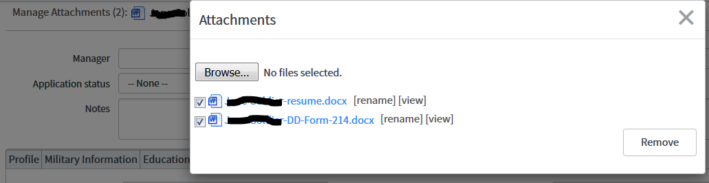

I extended the User (sys_user) table and added some attachment related columns (to allow for download/deletion via the portal). I created a Business Rule to clear these fields when an attachment is deleted. This works fine when only one attachment is deleted. However if you delete multiple via "Manage Attachments", the business rule runs only once and only one of the attachments related columns are cleared.
Any ideas on what I need to do to catch each deletion?
