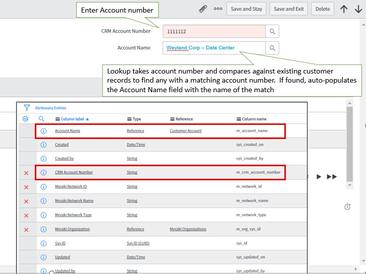

I would like to see if any of you can help with a challenge I am working through.   I have a form where I am attempting to align a user supplied account number from one table, with the existing customer account record from another table and I am having trouble sorting out the best way to do this.
To give you some context, this is part of an import set which is retrieved on a scheduled basis and then a provisioning engineer needs to reconcile customer sites with their hardware using the account number supplied from the provisioning process.
The idea is this:
  1. The user enters the CRM Account Number in the field
  2. onChange a lookup takes place which compares the "CRM Account Number" value with all known values in the existing Customer Accounts Table
  3. If there is a match, return the Name of the matching account and populate the Account Name form field

Sai Anna
small doubt before answering, One of your image says CRM Account Number as Reference field, and dictionary entry shows it as String. can you please give clear table name, field names and types. I can help with Script
