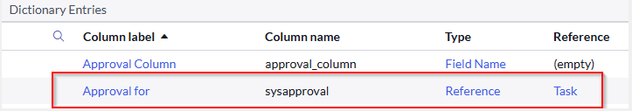

Can anyone assist me with why this query does not work?
   var requestID = '6f6416e5476c6610872475f4116d43d8';
    //Find all approvals where the parent is the same.
    var approvalQuery = new GlideRecord('sysapproval_approver');
    approvalQuery.addQuery('sysapproval.parent', requestID);
    approvalQuery.query();
    while(approvalQuery.next())
        gs.info(approvalQuery.sysapproval.sys_id);
I am looking to query the sysapproval_approver table to find all records where the "Approval For's" parent is the same.

ServiceNow support was able to figure out a solution:
approvalQuery.addQuery('sysapproval.task.request', requestID);
gs.info(approvalQuery.sysapproval.number);

I don't think the system likes the gr.addQuery('approval_for.parent', parentSysId); query.
I think it has something to do with the "Approval For" field being a reference field of the Task table.
