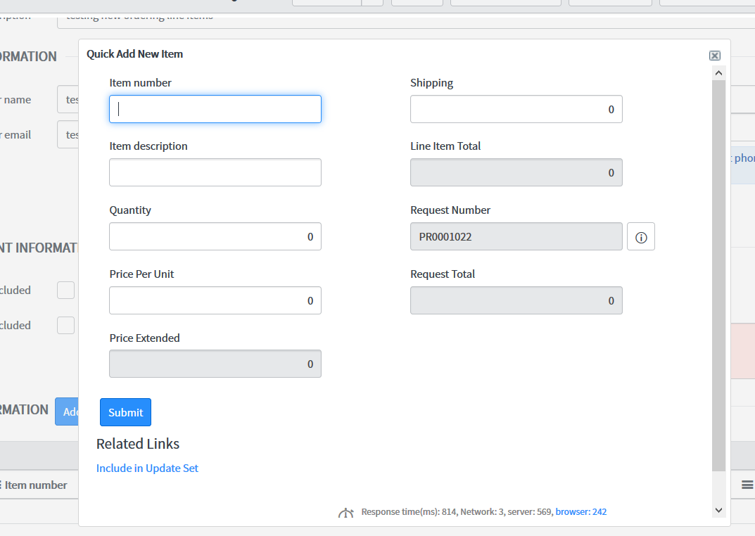

- I personally use a combination of screen shots in a MS PowerPoint slide deck, with notes, combined with a text file describing the choice selections used to create the file AND THE SCRIPT, see the attached screen shots.
