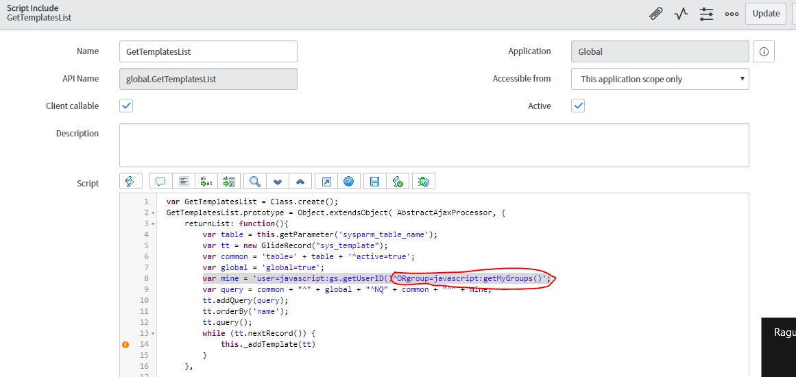

It looks like someone didn't want a single reference field and tried to implement a glide_list to allow multiple groups to the same template. The u_groups says this was a third party add on, either by your organization or some professional services. Ideally, they should have tested this. I can tell you know that it's not supported.
Can you check the GetTemplatesList script include to compare against what Rajesh has posted to see if there were any mods made there. Something tells me that it's out of sync. Someone somewhere tried to extend the template functionality to work with multiple groups and may have used a bad practice somewhere.

Rajesh T
Giga Expert
Go to below script include   and check if the highlighted condition existed or not.
