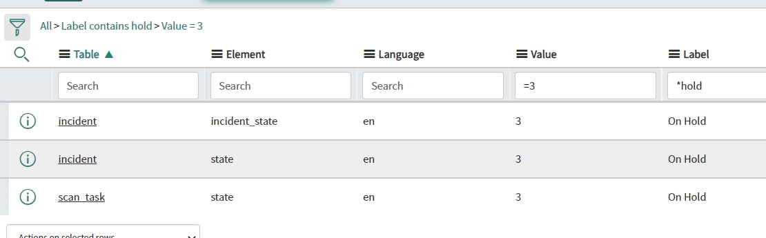

Hi Saurav,
I checked the dictionary as you said, and found the On Hold value for sc_task is 3.
Please see the screenshot below
Yes so you will have change the value of on hold to something else.
But before doing that once check if there are any scripts which are using this value of on hold. As it is a custom state i do not think you will have too much dependency but still better to confirm once.
Once confirmed you can change the On hold state value
