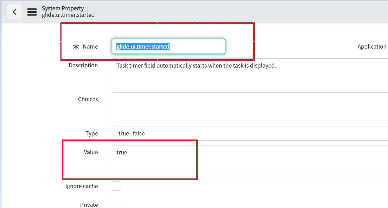

By default Time worked field will start running when form is refreshed or reloaded. There is a System Property which controls this behavior in ServiceNow i.e. "glide.ui.timer.started". Check if the value of this property is set as true or not . If this is set as False then the timer will not run automatically. Please refer to screenshot below:

shloke04, thank you for your information.  I updated the system property "glide.ui.timer.started" to value = true and now the time starts tracking time automatically.
