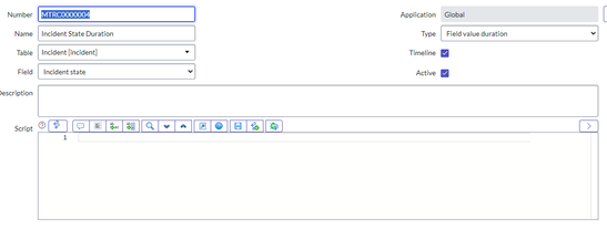

03-30-2024 05:32 AM
Create a metric defintion to capture state:
1.
2.
3. This will generate below result:
