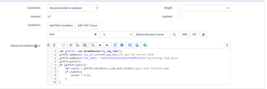

1. for advance condition try below code
var grRITM = new GlideRecord("sc_req_item");
grRITM.addQuery('sys_id',current.sys_id);//to get the current RITM
grRITM.addQuery("cat_item", "cbd3f97b97e4111097af9300f153af71");//catlog item sysid
grRITM.query();
if (grRITM.next()){
	var sapVal = grRITM.variables.u_sap_real_estate;//give your variable name
	if (sapVal){
		answer = true;
2. To call email script in notification use below
${mail_script:name_of_your_mail_script}
you given  email instead of mail

Hello Sir,
Just to revise the script to be more performance-optimized and when there is more than 1 such check box. Then the script would be:
grRITM.query();
if (grRITM.next()){
	if (sapVal == "true"){ //Pass 'true' here
		answer = true;

Thank you @PavanK960672992 Sir, This is working fine🙂. Solution Marked Helpful and Accepted as Solution.
Sure, will ask separate questions for such asks.
