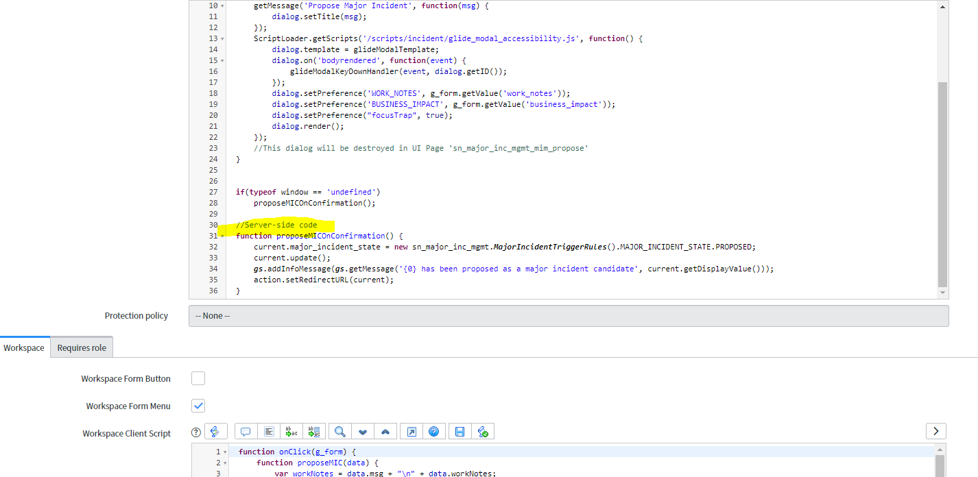

gsftSubmit calls the Server side Script of the UI action. Can you check whether the UI Action has Server side script.

‎12-10-2020 05:22 AM
it doesnt look like it has a server side script, see screenshot:
