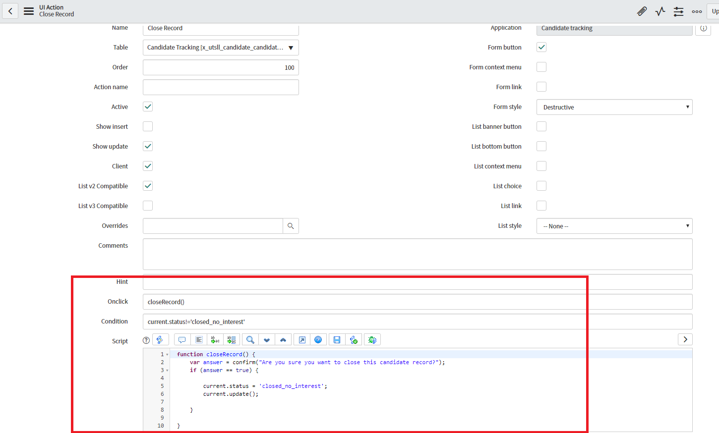

I have a UI action button and when it is clicked it asks the user for confirmation about closing a record (see pics below).
For some reason when I click 'Ok' on the confirmation, nothing happens. Is my code off?
I modified the code slightly and this worked:
function closeRecord() {
var answer = confirm("Are you sure you want to close this candidate record?");
if (answer == true) {
gsftSubmit(null, g_form.getFormElement(), "ACTION_NAME");
if (answer == false) {
return false;
if (typeof window == 'undefined') {
UpdateStatus();
function UpdateStatus() {
current.status = "closed_no_interest";
current.update();

It does not seem to be working, the form status does not update and it does not stay on the same record when it reloads, am I missing something?
I tried this on my incident table and it does work. (i changed the state value)
is the value of status the text value you entered? (and not an integer)
is the field name status? no prefix?
Yes, the field name is "status" and the value is closed_no_interest (see pics below)
When I click 'Ok", I am redirected to the pic below, and the status is the same
