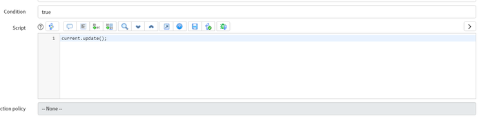

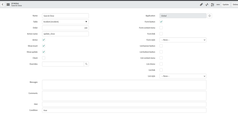

10-31-2023 06:03 AM - edited 10-31-2023 06:06 AM
@Ankita Kolhe Create UI action as below. No need to include onClick function. I tested on incident table and it works.
