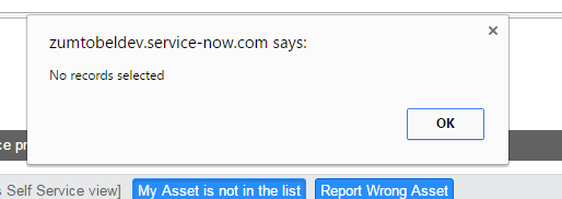

I am trying to create a UI Action that redirects to a Catalog Item but my current code is not working. It doesn't go to the Catalog Item. I will appreciate your help! Many thanks!

Hi Diane,
It looks like if you go the original route with the client script, and start your Action name with sysverb_, then the message is surpressed. See this thread for reference to Michael Ritchie's comment.
how to hide "No Records selected" alert on click of list button
