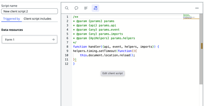

4. Additional thing we have to do is "Executing Client Script" when form is saved/submitted.
   -- > Client script to refresh the page is given below.
5. Add this client script to execute in event handler of "Glide From" controller event
   Event name : Form Submit Completed.
So, here whenever the new record is getting submitted it will loads the page. and removes the saved form values from "Form Default" Component
