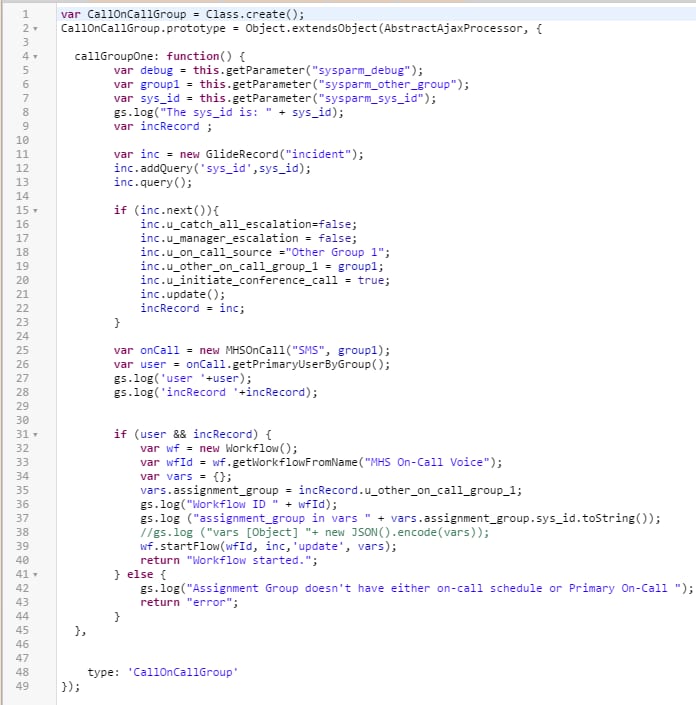

Maria DeLaCruz
After seeking help from our ServiceNow Technical Consultant, the UI macro is now working!
Here's the updated script include:
Here's the updated UI macro:

Thanks, Cory!     You are correct that this is on the incident form.
I gave this a try, but for some reason, it's still not initiating the workflow (no call is being made). I made sure that the script include is "client-callable".   Is there anything else I can check?
Hi Maria,
Are your debug statements showing up in the script log? These can be found in the Navigator under "Script Log Statements".
Are the values what you expect?
The startFlow() method will return a GlideRecord for the context which is being run. Try saving that into a variable and logging it's sys_id:
(replace line 31 in the Script Include):
var context = wf.startFlow(wfId, current, "update", vars);
gs.log("Context started: " + context.getValue("sys_id");
Does the context sys_id appear in the logs? If so, can you view the context by going to https://your-instance-name.service-now.com/wf_context.do?sys_id=context-sysid-here ?
This is what I'm getting in the Script Log Statements:
My group does have an active on-call schedule.
