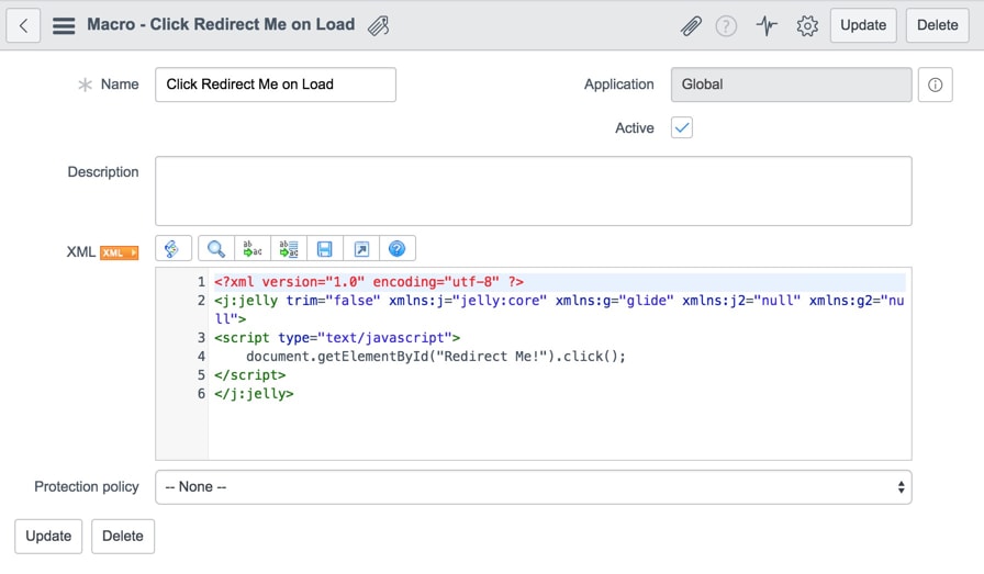

Is it possible from a UI Macro to call a Ui Action ?
There is some code on the instance here which does a few bits and loads from a UI Page and works well
However, I may want to call this routine from elsewhere (on the CMS) and that it is all Ui Macro driven
My initial attempts are not working and I am not sure if it is possible, a code issue or the click not being registered
Cheers

I created a UI action on incident table and then invoke it through UI Macro by bringing it in the Incident form as UI formatter.
UI Action:
UI Macro:
UI Formatter:
Now as a result of it, When I open any incident form it opens "www.servicenow.com" on a new page. Basically UI Macro is calling a UI action.

This will surely work, but it will violate technical best practice as it uses document.getElementById.
If the code in the UI Action is pure server side you could to a gsftSubmit with the action name as parameter. Unfortunately there is not a lot of documentation around this method though.
