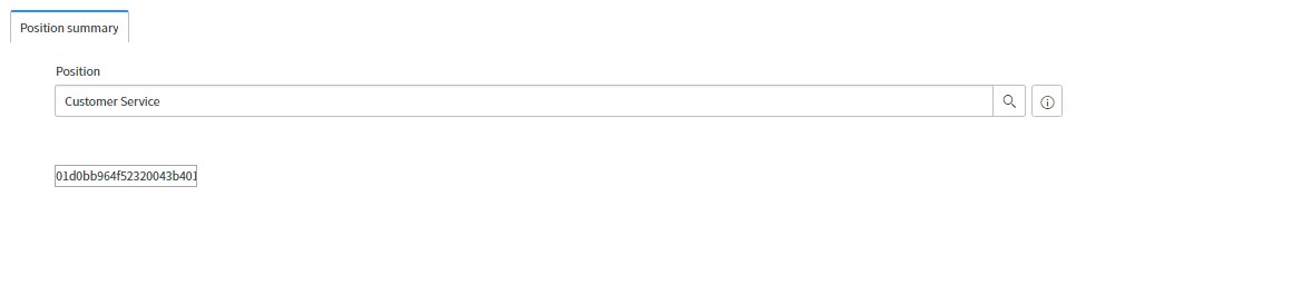

So, I think I've passed in what I need to do my coding. It's not ideal necessarily, there might be a cleaner way, but this is what I ended up doing (following the correct answer on this community post: pass value from variable to UI macro )
This is the macro:
  <input type="text" id="position_id" name="position_id" value=""/>
  <script>
  function setPosition(text){
  $j("#position_id").val(text);
  </script>
</j:jelly>
On the form, I created two client scripts, one onLoad (because the form can inherit the value from an order guide) and one onChange of the Position field.
onLoad:
function onLoad() {
    setPosition(g_form.getValue('position'));
onChange:
          return;
  setPosition(newValue);
And now I'm finally getting the sys_id in a field (I'm going to hide it, the user doesn't need to see it, I just need it for scripting).
