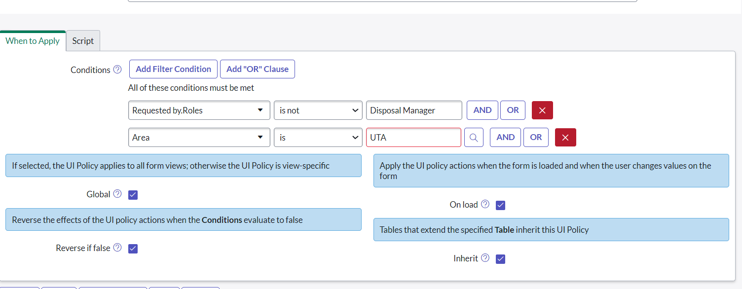

In the Change Request form, the 'Category' field depends on the 'u_area' field. When a user selects 'UTA' in the 'u_area' field, four options ('Asset Replacement', 'Asset Transfer', 'Asset Name Change', and 'Asset Disposal') are available in the 'Category' field.
However, a specific requirement entails that if the user selects 'UTA' in the 'u_area' field and possesses the role of 'Disposal Manager', only the 'Asset Disposal' option should be visible in the 'Category' field along with the others, but not visible otherwise.
This is working for other fields that are not dependent, however not working on dependent fields. Need your suggestion

If the same logic in the Conditions is working for fields that are not dependent, scrap the UI Policy for this one and try a Client Script instead.  You'll have to use g_form.getValue('u_area') to test the value of this field, and a getReference on requested_for to check the Roles field - being sure to test for the value of the Disposal Manager role, not the display name.

Hi @Brad Bowman   Thanks for your reply. I have tried with the following client script, but it is also not working

@Brad Bowman  I checked with a message that the client is executing, but it is not changing the value of the dependent field. If I did the same for another field which is not dependent, the script is working fine as expected.
In both cases the system is retrieving the dependent category choices when the area changes, likely after your script has completed.  Try setting an interval or timeout prior to the clear or remove.  Since it's reloading the choices with every change, you should just need to remove the one choice if they don't have the role - no need to clear all and re-add the other choices:
