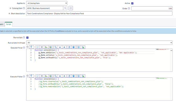

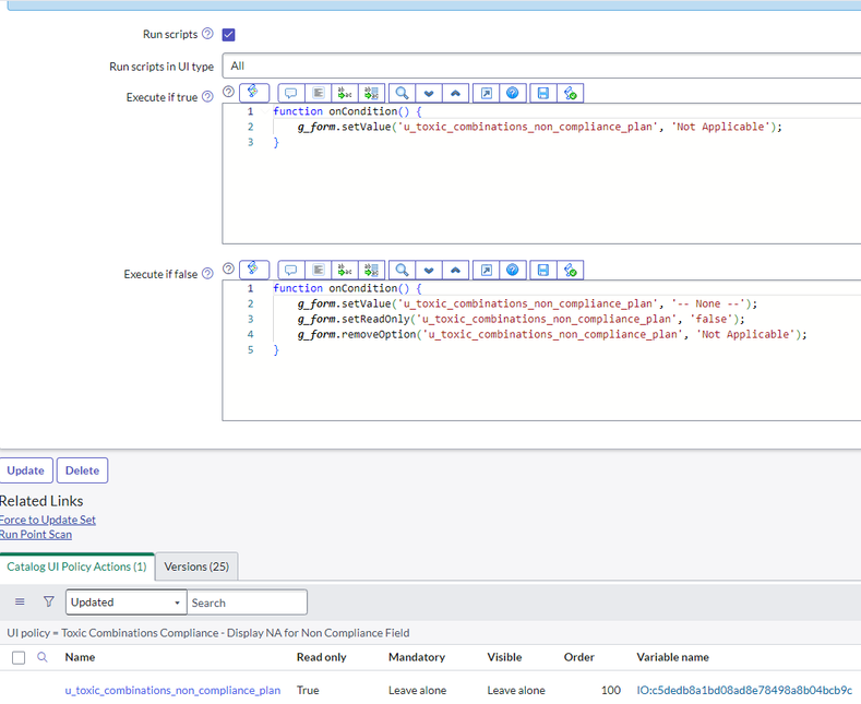

I've got the following UI policy for a catalogue item that is used to update the value of a certain field when the conditions are met:
The script of the UI Policy is:

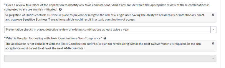

However, what I'm finding is that if I go onto my catalogue item and trigger the UI Policy, it's not setting the to field to Not Applicable, but Read Only:
So I was just wondering if anyone knows why the text specified in SetValue is not working as it should?

Seems like you are using the setValue to the choice field, so make sure you're using the backend value to set the value in the field.
g_form.setValue('u_toxic.......' , 'not_applicable'); //make sure to write the backend value here

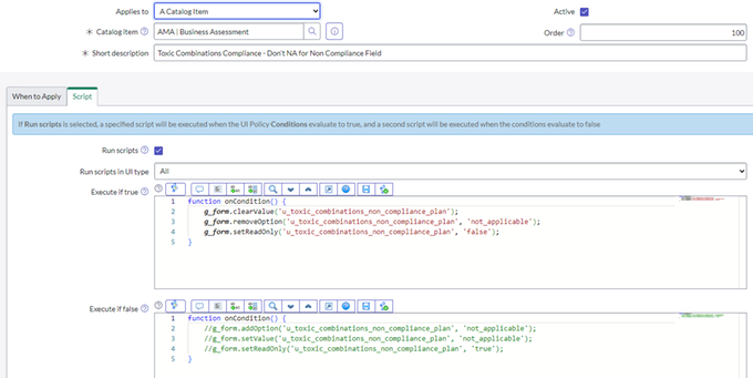

I've now made two UI Policies:
Whilst it does make the field Read only when it correctly should, it's not adding the value of 'Not Applicable'

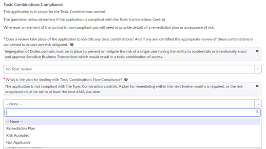

I've added the choice back in, but when I don't want it to appear, it's started appearing:
I don't want it to show in this scenario
