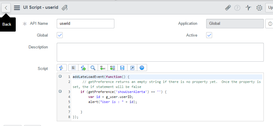

Hi Kenneth,
On the Client Side, you can use getPreference('name of user preference') and setPreference('name or user preference', 'value of preference) to handle user preferences.   So for example:
addLateLoadEvent(function() {
        // getPreference returns an empty string if there is no property yet.   Once the property is set, the if statement will be false
      if (getPreference('showUserAlert') == '') {
              var id = g_user.userID;
              alert("User is : " + id);
              setPreference('showUserAlert', 'true');

Hi Ashish,
I just checked the solution I offered in Fuji and it worked for me.   Can you share some details / screenshots of your script and the result?   I'd be happy to help troubleshoot.
Kind regards,
Travis
On loading a page its giving undefined. Its working after the homepage loads and will navigate to any module.
Hi Ashish,
Thanks for pointing this out.   I did not catch it before.   The first thing to note is that as a global UI Script it will run on EVERY page, including the header frame and navigation frame.   There is a pretty good chance g_user doesn't exist in those frames.   Also, it appears that g_user does not exist on homepages either.   This seems consistent with the wiki requirement that g_user can only be used in client scripts.   So you could either swap g_user for a GlideAjax call that would obtain the user info or you could just check for g_user and only run the script if g_user exists.   Here is an example of the latter, also note that I swapped alert for confirm to make testing easier.   Click cancel and the user property is left alone.
  if (getPreference('showUserAlerta') == '') {
        if (g_user) {
            var ans = confirm("User is : " + id);
            if (ans) {
            setPreference('showUserAlerta', 'true');
