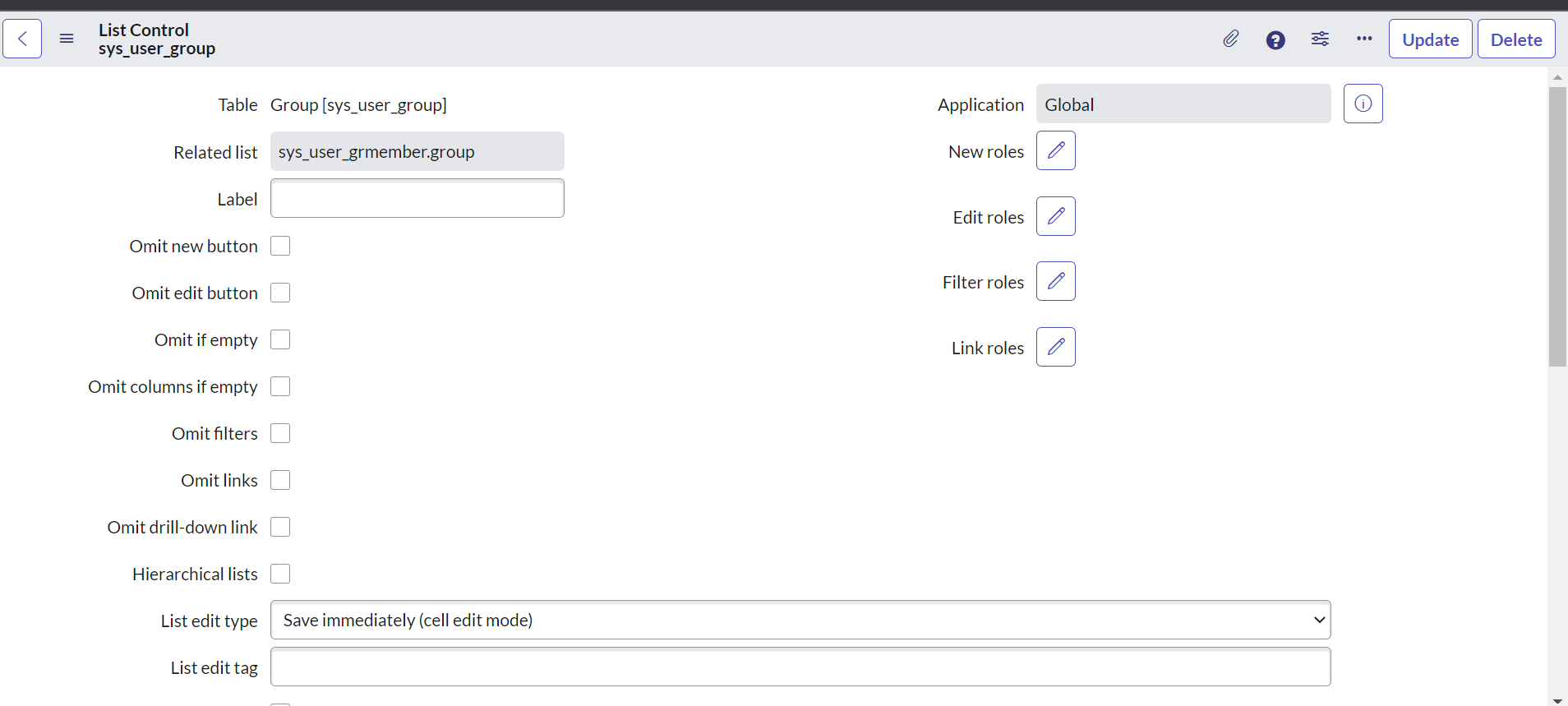

Created list control for sys_user_grmember.group with condition as only group manager need to see edit option in group table related tab. But when I am trying to add user to group it showing an error as " action not authorized", what might be the issue, please check the attachements.

01-24-2023 06:37 AM
provided all roles required, but when I remove list control its working fine

01-24-2023 07:08 AM
If I try to change the current.manager, its not working.
Is that restricted by "(new GlideRecord(current.getTableName())).canCreate() && RP.isManyToMany() && !RP.getListControl().isOmitEditButton() "this ui action condition ?
I remove isOmitEditButton, I can Edit,,but not satisfying the group manager,,
