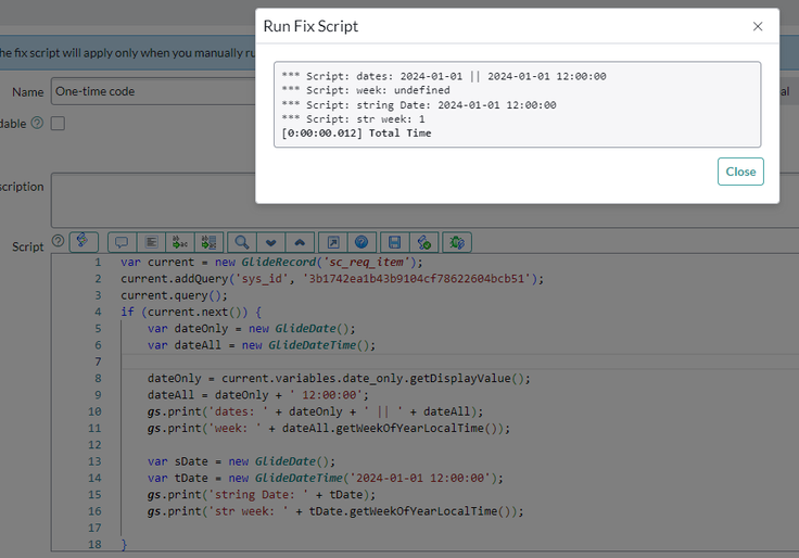

I have a business requirement to extract the week of the year, month and day from a given date in a catalog item.  This will be done in a script in a workflow.
However, I'm not getting a value back, just "undefined" and I don't understand why.
Here is my test script:
var current = new GlideRecord('sc_req_item');
current.addQuery('sys_id', '3b1742ea1b43b9104cf78622604bcb51');
current.query();
if (current.next()) {
    var dateOnly = new GlideDate();
    var dateAll = new GlideDateTime();
    dateOnly = current.variables.date_only.getDisplayValue();
    dateAll = dateOnly + ' 12:00:00';
    gs.print('dates: ' + dateOnly + ' || ' + dateAll);
    gs.print('week: ' + dateAll.getWeekOfYearLocalTime());
    var sDate = new GlideDate();
    var tDate = new GlideDateTime('2024-01-01 12:00:00');
    gs.print('string Date: ' + tDate);
    gs.print('str week: ' + tDate.getWeekOfYearLocalTime());
And this is what I get when I run the script:
Does anyone know why it works when I pass it a string but not the variable?  I've tried converting the variable to a string, but it doesn't make a difference, it still has the value "undefined".
