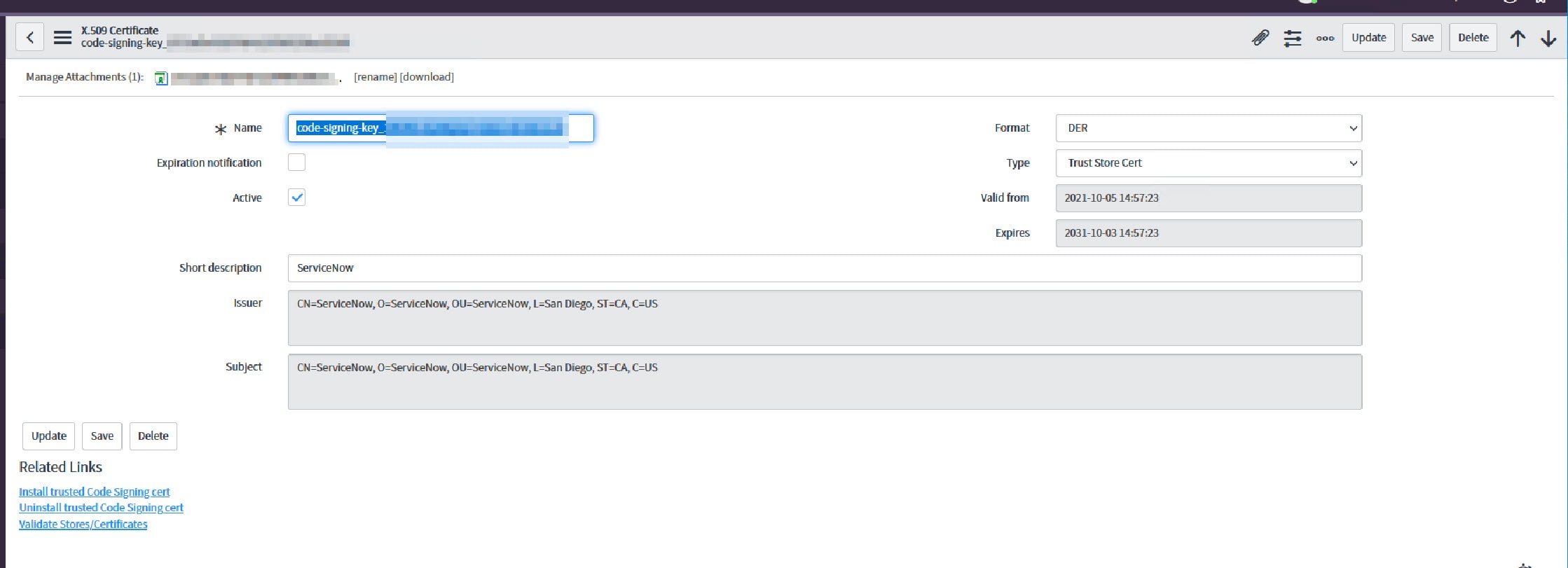

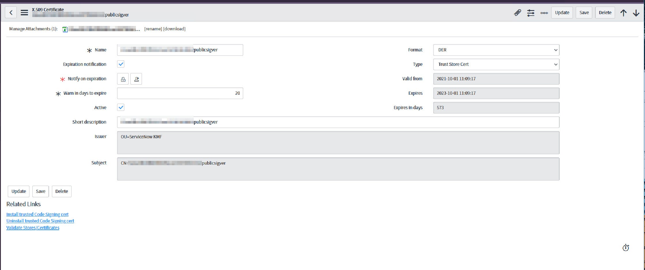

Please help!  Over the weekend we upgraded our test instance to Rome from Quebec on 3/5/2022.  I happened to look at the System Logs when testing to make sure LDAP sync of users/groups was working.  I saw some "unable to load certificate..." errors that started hours after the upgrade to Rome....  I am a new ServiceNow Admin and this is the first upgrade happening under my "watch" so I am unsure what is causing the errors and if they are something to worry about.
When I navigate to System Definition -> Certificates I do see both certificates listed and they appear valid..  Note the errors appeared after the upgrade to Rome on 3/5 since I do not see any earlier errors of the same type previous to that date...also when I look in the prod system logs I don't see the same errors.
Please see screenshots attached.  I have blurred out identifying info on the pictures, but you can see that there is one "Unable to load certificate....publicsigver " error (it actually repeats in the log) related one certificate appearing in the Systel Log, and also a "Unable to load certificate : code-signing-key..." error (which also repeats in the log).

Thanks @Vasantharajan N .  I ended up contacting ServiceNow Support and they say it is likely related to this.  The are helping to install the KMF plugin in our instances and then will enable "Ignore cache" if needed.
