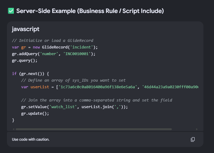

I've tried returning a string and an array to the business rule to populate the collaborators field, but neither works.
I followed this example I found on Google, it seems straight forward.

The behavior you saw in your PDI with the quotes is expected JavaScript behavior.
This is valid:
var userList = ['be82abf03710200044e0bfc8bcbe5d1c', 'af2a757b1b74c4500750fc87cc4bcbc1'];
The sys_ids have to be quoted because they are JavaScript strings.
This is not valid:
var userList = [be82abf03710200044e0bfc8bcbe5d1c, af2a757b1b74c4500750fc87cc4bcbc1];
Without quotes, JavaScript treats those values as variable names.

I did try the Google code snippet in a business rule in my PDI and it didn't work there either.  However, when I added single quotes around each sys_id, it worked.
Here's the business rule I created in my PDI on the incident table:
    // this list works
    var userList = ['be82abf03710200044e0bfc8bcbe5d1c','af2a757b1b74c4500750fc87cc4bcbc1','b682abf03710200044e0bfc8bcbe5d0f'];
    // this list doesn't work
        var userList = [be82abf03710200044e0bfc8bcbe5d1c,af2a757b1b74c4500750fc87cc4bcbc1,b682abf03710200044e0bfc8bcbe5d0f];
    current.setValue('watch_list', userList.join(','));
})(current, previous);
With this information, do you see anything else I may be missing?
This is valid:
This is not valid:
