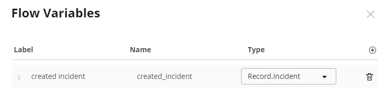

Since the Created Hardware Record is in If block and you are trying to update it outside, it will not let you select the record.
As a workaround
Create a flow variable to store the reference of the created record
in your case it will be reference type alm_hardware
In the flow after you create the hardware, set the flow variable to the hardware record.
Later in your update record, you can select the record from the variable
