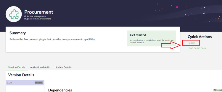

I recently reset the procurement plugin back to OOB via the repair option in the plugin.
Is there a way to undo this? I want the tables and forms to go back to exactly as they were before I repaired the plugin.
