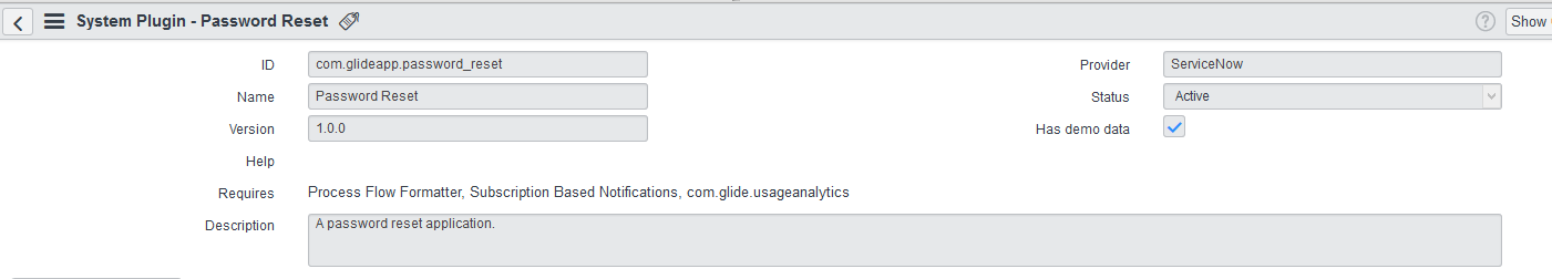

Anyone could suggest the best way to troubleshoot the OOB password reset function in an Istanbul instance?
The Password Reset Plug-in is enabled and the password reset can be accessed by the URL below
