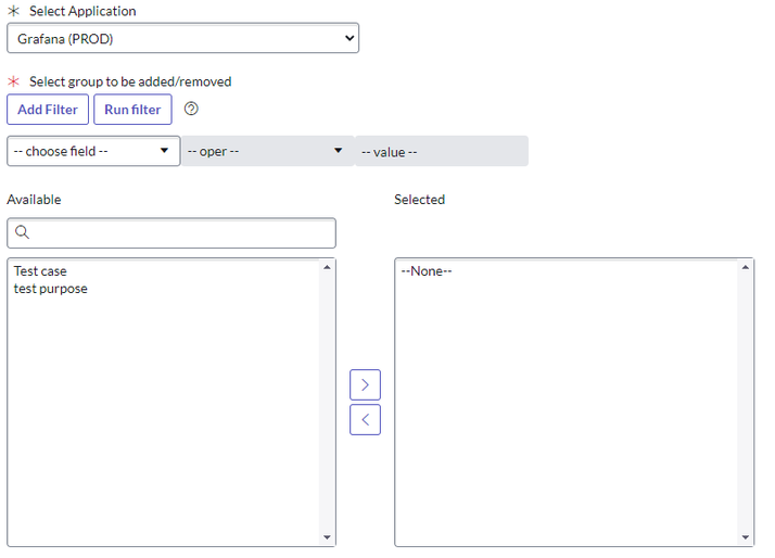

Hi @Markus Kraus ,
Thank you for the very detailed explanation and scripts :).
I can see through the debugger, that the group is parsed successfully from the script include:
{"status":"success","message":"","groups":[{"value":"d6bb6c131b1d15d4ff17dac8b04bcbc8","name":"Test case"}]}
Though the list collector is still not limited to only show the single group, but still show both groups:
Basically, I would like that only "test case" is available to above scenario.
Best regards
Anders
Best regards
Anders
