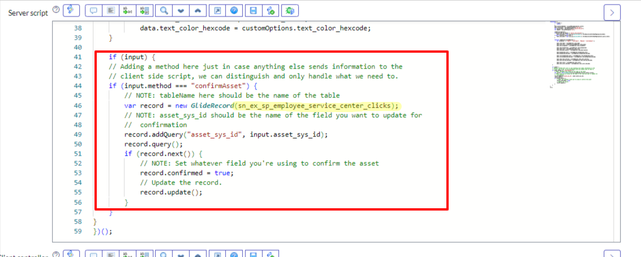

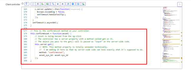

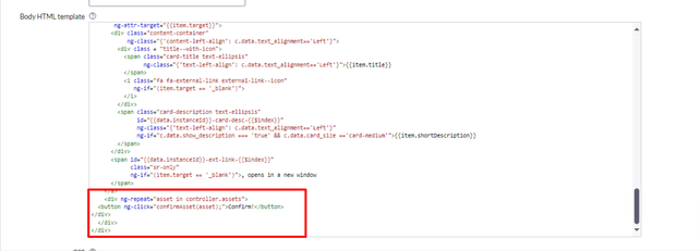

‎03-05-2024 04:07 AM
Wondering if you can help, I am trying to implement the above.
Requirement - when a widget is clicked on the ESC, it counts the clicks. Specifically using the Quick Link widget (or a customised variation of the widget).
Based on the above I have added this to the HTML:
This to the server script:
This to the client controller:
As you can see in the Server Script, I have created a new table and referenced it where required, but do I need to add anything else too it?
Any help appreciated!

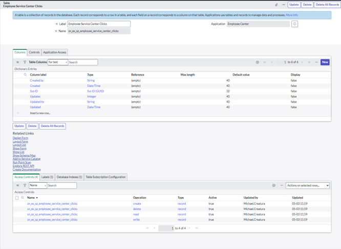

For that table, I did add a single field which is a reference to the quick link table.
Now, when I click the link, I see the following in that table:
I am attaching an update set that has this in it. If you put this in a fresh PDI, you should see everything there.
