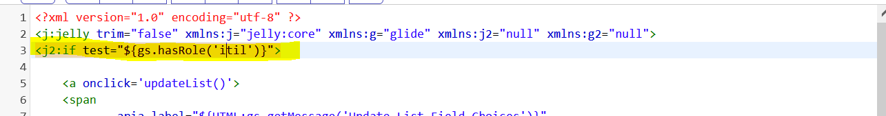

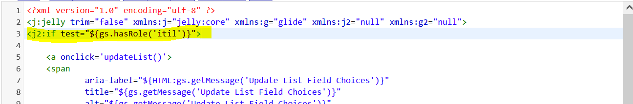

Yogesh14
Hi Yousaf,
I tried the below and properly closing </j2:if> at last but it is not working.
Yogesh

Hi Ankur,
For Admin role it is working fine, adding new options in new value field and getting alerts as well. But for other users i am only getting alerts but the new options are not adding up.
also i tried to add this line of code but it is not working.
<j:if test="${gs.hasRole('itil')}">
</j:if>
