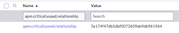

The System Property I'm using in my script is is:
However, what I've found is that if I replace the old code dbv.addEncodedQuery('barelps_type=3a174f47db5dbf0073609ab9db961964^ba_install_status!=70^ba_u_cbp_tierINTier A,Tier B,Tier C'); with   dbv.addEncodedQuery('barelps_type='+criticalRelationshipType+'^ba_install_status!=70^ba_u_cbp_tierINTier A,Tier B,Tier C');
