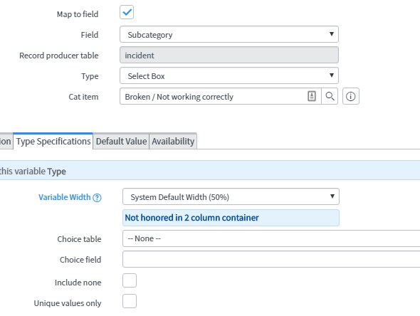

On Subcategory variable, did you remove reference to choices:
Hi Michael,
Okay removed Choice table: Incident, Choice field: subcategory and now see no values.   Also I might be mixing up my SN terminology.   I am using the same out-of-the-box catalog item you referenced to directly create an Incident record vs. passing through a workflow.   Thought this method was called a 'record catalog item record producer'.
-Wesley
