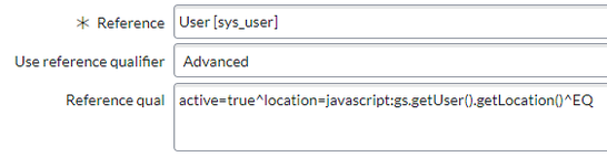

There is a much easier way to do this, without requiring a script include.
gs.getUser().getLocation() returns the location of the logged in user. In the reference qualifier of your variable, you can use it as follows -
javascript:gs.getUser().getLocation()

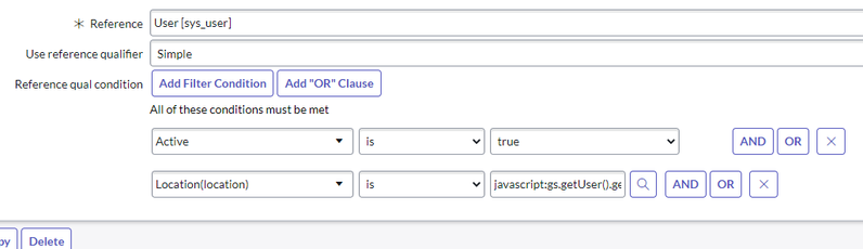

11-30-2022 02:36 AM
Hello @JordyZ
Please see attached screenshot
IN your script include those lines are missing. They automatically populates when you create new script include. Please mark your client callable checkbox to true.
After 2nd line you can insert above code.
Please mark my response as Correct / Helpful based on Impact.
