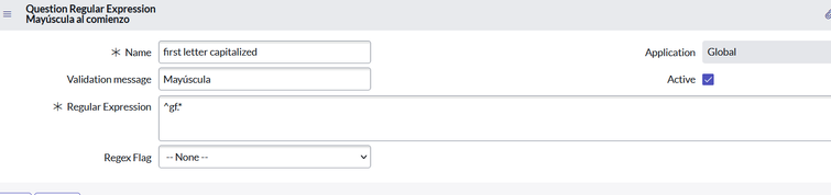

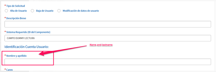

Hello dear community, I need help:
I need that when a person enters their first name, he types it with the first letter capitalized and when he types their last name also the first letter is capitalized (Example: Jean Graham)  I have tried using Variable Validation Regex but without success. Can someone help me with this please?
Validation Regex

Hi Alessa,
Not a very best regex but it is working for normal first and last name try this if you cannot use it with Variable Validation regex try it in client script
^([A-Z]{1}[a-z]{2,30}\s[A-Z]{1}[a-z]{2,30})
here is how you can use : Field validation: Regular Expressions
