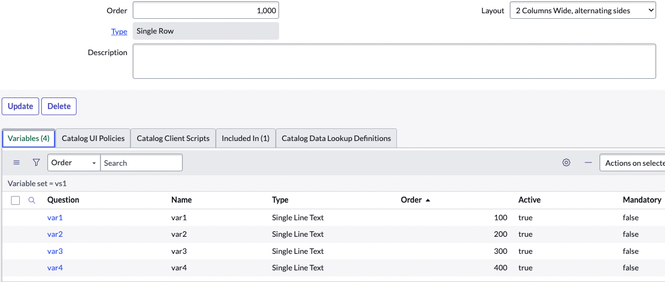

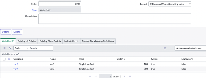

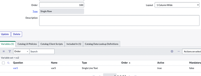

Portal/Employee Center handles this different than the backend, so you will need 3 variable sets.  No containers or splits needed, but the first and third need to have a 2 column layout

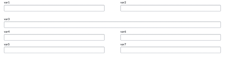

I was able to achieve this within one variable set:
Here's the magic:

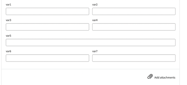

So here is what I have and how it looks in both the backend and the portal - ultimately I'm wanting it to look right in the portal/employee center.
This is what it looks like in the backend:
This is the portal view:
