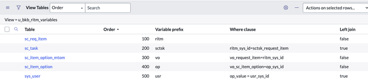

You could add the sc_item_option and sc_item_option_mtom tables to your database view, but I'm curious about the purpose of a view on sc_req_item and sc_task. Would the same purpose be served by a report on the sc_task table - which also contains the variables object - dot-walking on the request_item field to show the fields needed from the sc_req_item table?

That makes sense. Adding the variable tables to your Database View will cause there to be a row for each populated variable, so that may not be what you're looking for in this case, but the View would look something like this:
The Question and Value columns from the 'op' table are what you're looking for. The addition of the sys_user table is due to what you will see regarding reference variables when doing it this way. The Value of the variable will be the sys_id, so adding in the referenced table allows you to display a field (Name) from that table to make it readable.
