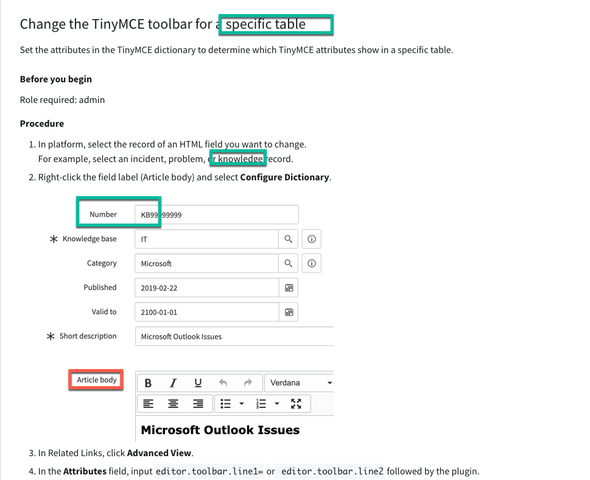

it does show the same thing, but it also does show you this:
and since you talk about knowledge and that is the example given, maybe try the steps identified and see if you have an override for that table.
Here is example of mine, where I just added the item in green that was not there before:
emir
some tables override the default property, see more here

that article shows the same thing i verified above
emir
