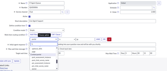

To route Virtual Agent conversations to different live agent queues based on the portal:
Steps
  1. Create separate AWA Queues (awa_queue) for each portal.
  2. Open the queue record and set Condition Mode to Simple.
  3. Add the portal condition:
    Context.portal IS 'SP'
  4. Configure similar conditions for other queues by replacing the portal value with the corresponding portal name.
  5. Save the queue configuration and test the routing.
