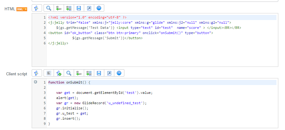

‎06-02-2017 09:17 AM
Hi Chuck,
Below is screenshot of the HTML and Client Script
When I enter data from within the system via the UI Page, data gets inserted.
But after logging off and submitting the same from browser, the record is not created.
There are no error or warning logs.
