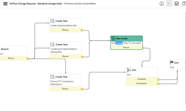

I have a requirement When a change request is cancelled all pending change tasks have to be put on state "cancelled" as well. Currently they remain on "pending"

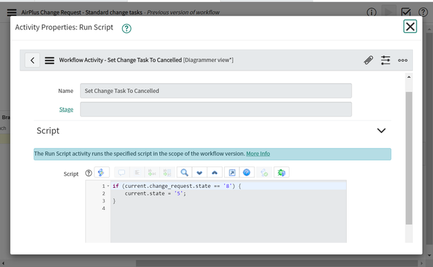

I tried this script in the workflow
And add this here
But it is not working and I also tried UI policy, scripts but it is not reflecting on change task, please send any suggestions on how to accomplish this.

I guess this workflow is running on the change_request table?
If so, you'll have to lookup the tasks before you can close them. You are currently only updating the state of the change itself.

Or use the script @Sandeep Rajput provided in your workflow. Should work exactly the same (excluding the first and last line)
