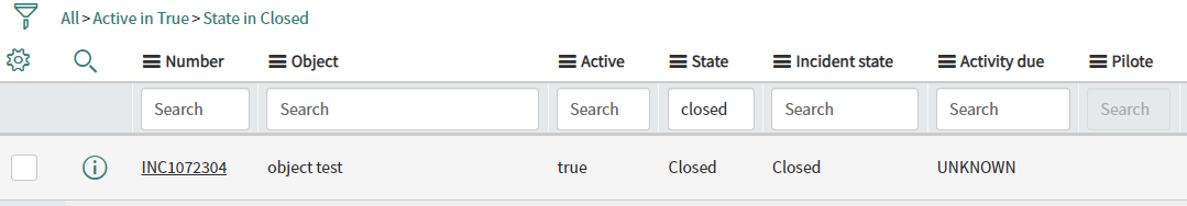

when an incident state is closed active=true not false and when I want to change active to false manually there are some incidents active  change to false but some incident active  remains true .
how I can solve this problem once the inicdent is closed active = false and how I can correct incidents that are closed and active = true becomes active = false.

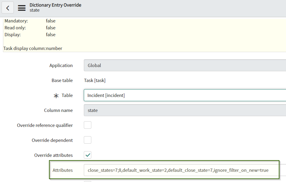

Okay, here the long way:
(1) Right click on "state" field then "Configure Dictionary":
(2) Scroll down to the Related List "Dictionary Overrides" and select "Incident":
(3) Find the state value definitions at field "Attributes":
These values are more important than the "Autoclose" Business Rule!

It seems that you have some customizations at state definitions.
Please go to
https://<YOUR INSTANCE>.service-now.com/nav_to.do?uri=sys_dictionary_override.do?sys_id=73da1af73b10130050bec9bb34efc494
and check the values at field "attributes". OOTB there is the following definition:
close_states=7;8,default_work_state=2,default_close_state=7,ignore_filter_on_new=true
For more information please see https://docs.servicenow.com/bundle/quebec-it-business-management/page/product/project-management/tas.... Yet it is concerning another table the same rules apply to the Incident table.
Also interesting is the documentation of the TaskStateUtil class which handles setting of active regarding the state: https://developer.servicenow.com/dev.do#!/reference/api/quebec/server_legacy/c_TaskStateUtil
