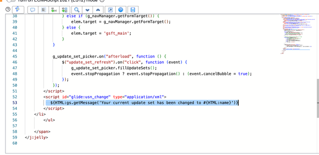

Does anyone of you have any idea where does this message come from when update set selected is changed:
Is it an addInfomessage?
If it isn't, is it possible to make a custom one similar to that one? How?

Hi @Rain Vaine ,
Navigate to sys_ui_macro.LIST
Filter with Name: ui_update_set_picker
It's on line 53.

Hi @Rain Vaine ,
It's on line 53.

Hello @Rain Vaine
Okay.... I think Nijmuddin pointed from where it is coming from.., just to provide this information so it can be helpful next time...
You can search any info message from the studio application to know where it is coming from..
Navigate to System Applications > Studio
Click the Open Studio tab
Select an application
Click the Code search button in the upper right corner
Enter a search term
Select whether to search in all applications or select a table to search from
Click Search
