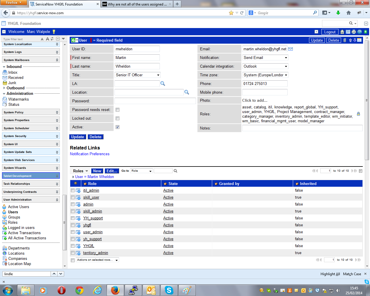

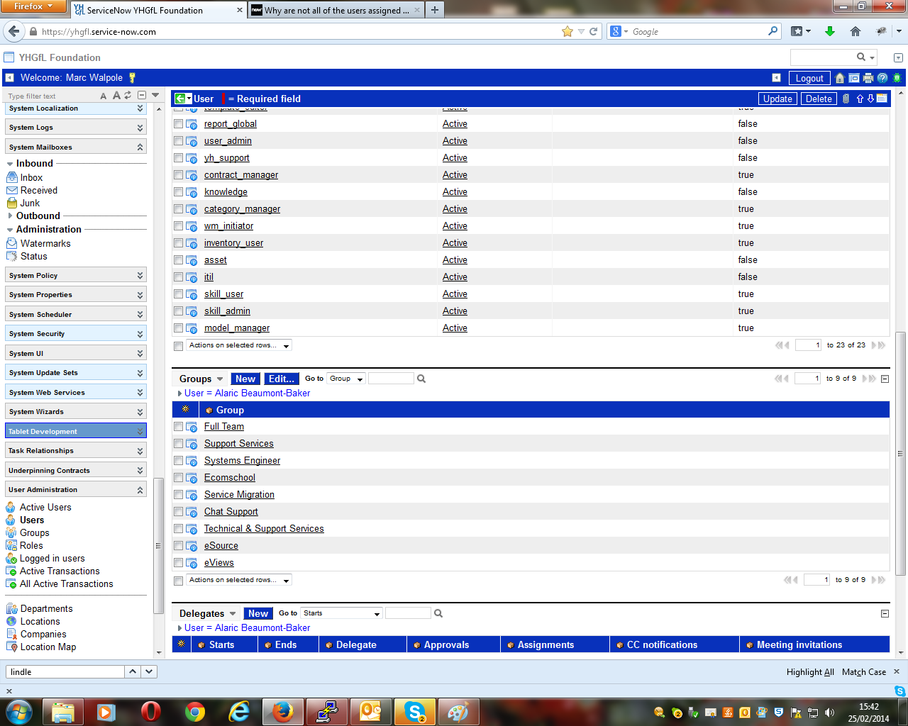

Any chance you can provide a snapshot of the users roles and the group itself?
Hopefully this works.   The first user works.   The second user doesn't work.   Group shown at bottom, its very much just a collection of users.
