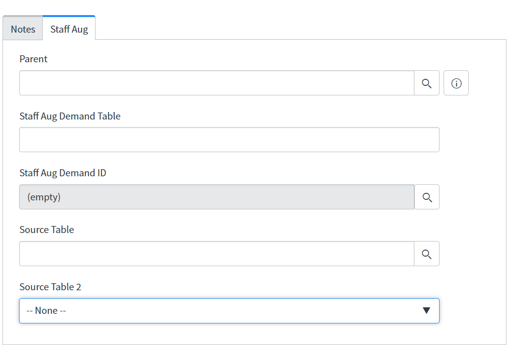

I've written a very long email script to display many fields on a task notification per the requestors preference.  Problem is, I can't easily grab the sys_id out of a field like I have in the past from approvals. I'll add the relevant part of the script below along with the various fields that I've tried to add and configure to get the sys_id (I've tried adding a document id field to the task record, perhaps incorrectly) I would greatly appreciate any guidance.

The table is dmn_demand_task, the record that I need to retrieve the sys_id is on a custom demand child table.  I do need to query with the sys_id. That's the issue I'm having. I don't know how to get the sys_id of the related records/parent demand.  I was just trying different things when I took the screen shot.  I tried querying a lot of different ways with sys_id. The problem is that I can't successfully save the parent records sys_id into a variable to put in the addQuery line and I can't seem to successfully get it using something like current.parent.sys_id.  That's why I was trying to make a field on task that contains the sys_id. Something else I've tried that didn't work: find_real_file.png
