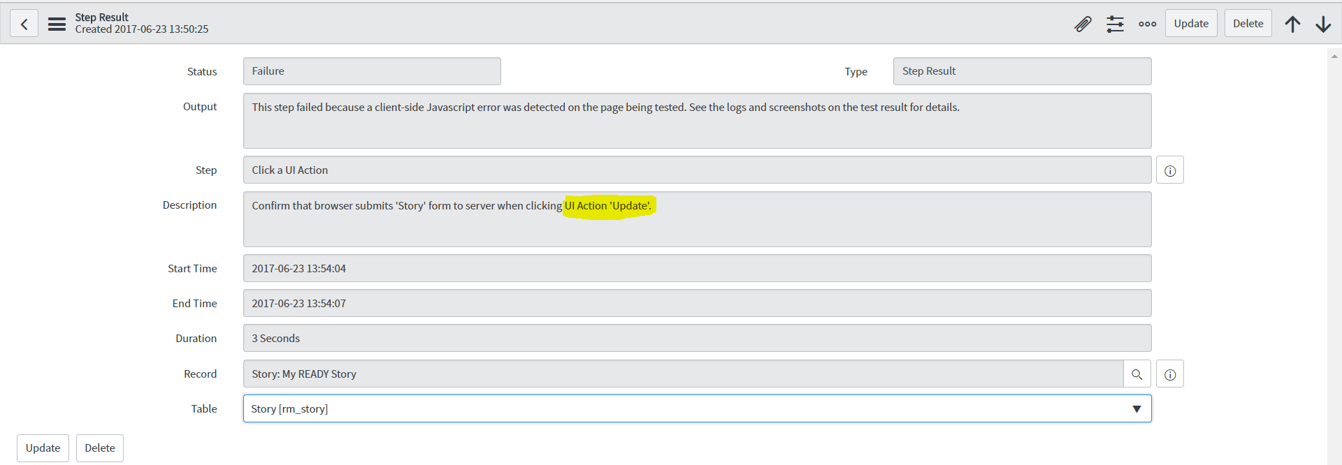

I have created 5 Tests, which complete successfully when run individually, but 3 of them fail when run in a Test Suite.
Specifically, the 3 which fail (all fail with the same pattern), deep into the Test by failing on the same "Update" UI Action:
even though the previous "Set Fields Value" step completes successfully.
because it can't find the record it just updated...
NOTE: Each of these 5 Tests run successfully individually.
Any hint is well appreciated.

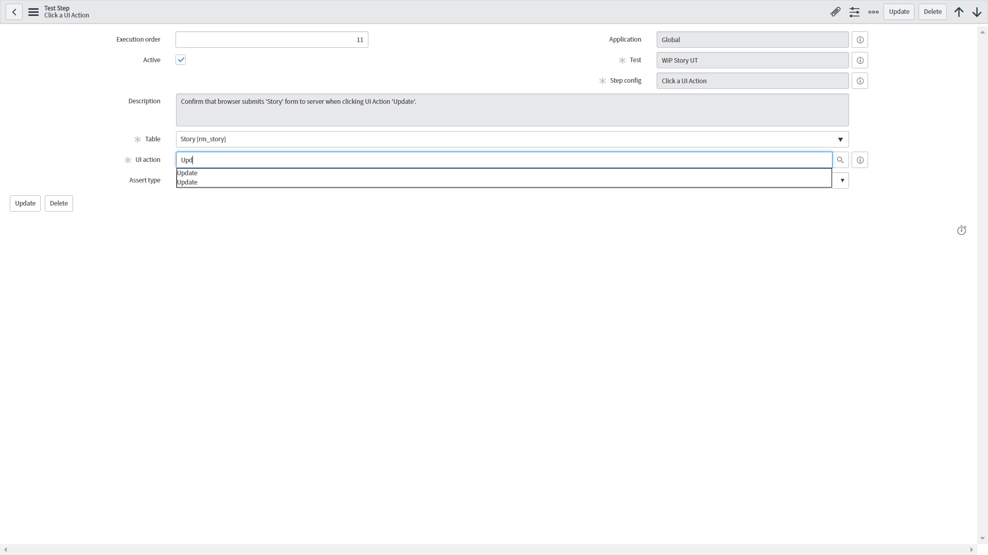

- Even when I run the Test individually (i.e. not in a Test Suite), when I change who I impersonate earlier in the script, then usually the same Update UI action step fails with the same "record not found" error, even if I run the Test individually (vs in a Suite). If I update the step again - deselecting the Update action and reselecting it - then the UI action completes successfully when I run the Test individually.
- Several UI actions (incl. Update, Delete) actually have multiple options for the same action, and I have no way to distinguish the difference between the two.
It feels that these two additional tidbits have a correlation relationship with the behavior, albeit perhaps not a causation relationship.
Do you know more about the multiple options for the same value?

So I was able to distinguish each of the Update actions, but it requires selecting each and getting information about each,
so I made sure that I selected all Update actions which corresponds to the sysverb_update verb, since it is supposed to return to the previous screen.
