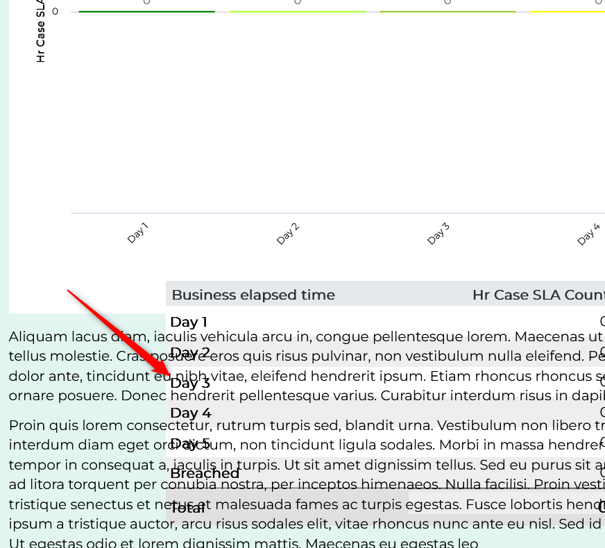

Since we upgraded from Rome to Tokyo, we are experiencing a problem with our portal.
If we use the Report widget and include a report with data display the widget overlaps with the widget below it.
We do not have the problem with Rome (in production) and we have the problem everywhere in DEV, ACC instances with Tokyo
The problem is on the portal, but we can already see the same problem on the page designer
Here you can find 2 screenshots with a page as example
01-23-2023 03:42 AM
Info received from Snow Support : The dropdown for adding Performance Analytics and reporting widgets is broken on Service Portal - Kn...
Fix will available in Tobyo Patch 4

01-22-2023 01:25 AM
Hi Sandeep,
Not related to the Brower. (all browser)
I tested in my PID, same problem.

01-23-2023 03:42 AM
