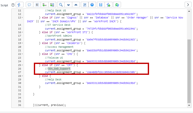

In the Business rule: When the workflow catalog task option did not provide the proper assignment group for the task after the test ticket, I began to look at business rules and I found that for this be that is active for 'Generic Password' is to assign the assignment group - I updated this code. (see figure 2)

Figure 2:

If you have Both BR and WF, there could be conflicts.
Can you confirm what type of BR it is?
and which logic you want to have final authority on the flow.
If you want to keep workflow logic, update order of business rule to 1000 or greater
If you want to keep BR logic, keep order of Business rule below 10000

Thank you for your comment, the br is pulling from the Catalog Task [sc_task] with the order of 1 and when is set to before.
I think there is something I am missing because neither of the two updates are working, I have found that we have many 'backend' relationships but no documentation or reporting to dictate to a new member within our ServiceNow team to identify what is applied to what.

The BR would work better because it encompass all the various passwords resets for a specific flow type.
The BR is on the sc_task, to run before , order of 1 and no conditions.
